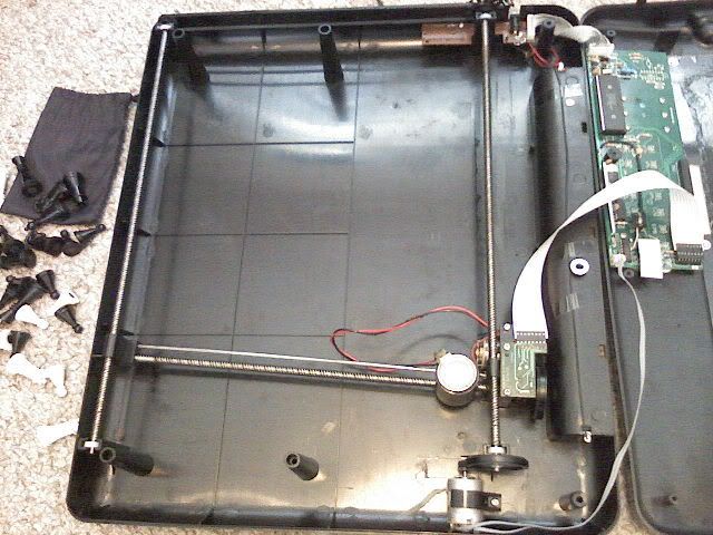

Looking again inside my computer, I know why there is a strange angle in the magnet guide rail in your photo.
At top, both parallels rails have a pulley and they are united by a strap. The strap synchronizes the movement of both rails. If you take out the strap you could adjust every rail in single way in order to get the magnet rail would be in good position, 90ΒΊ orthogonal with the both syncronized rails.

I got it to work some what. :-) It some time stalls after 20 mins of play or from resetting. I really think it needs to be oiled. About the angle...I really don't know.  I also see that from your pic that your pieces are different then my chess set. But it still works.
I'm going to try put some oil on and I will post what happens.

The most problems are due to the movements during the trip:
1.- Look the cables in the electric motors, some times the cable is separated due a weak weald.
2.- Look the 2 iron rail guides (looks like a long screw)  for the movement are fixed in correct positions, into its plastic supports, some times, the guides are out of order. In your photo the supports looks like in order.
3.- Look the serial cable between the sensorial board and the main board, some times it's broken.
4.- I see in your photo an strange angle in the magnet guide rail, why? It must be at 90ΒΊ with the other 2 and at 180ΒΊ with the sides.
5.- The turn for the silly question: did you try de ACL key for a reset?. This computer remember the last position in its memory and perhaps it is trying to move pieces that they are not on the squares.
6.- Of course, a little of motor oil for rails could be good too.
7.- The most silly question: have you removed the safe screw of the bottom? See the last photos into my link above this lines.
This is a classic chinese excalibur product ;-)

I have a question on the  Excalibur Mirage chess set. I have just got one from a friend and it just says stall, makes all kinds of noise. Doesn't move. I wanted to find out if there is a way to repair this and if you have any guides.
Here's some pics of the insides and the video from the main page. (links):
