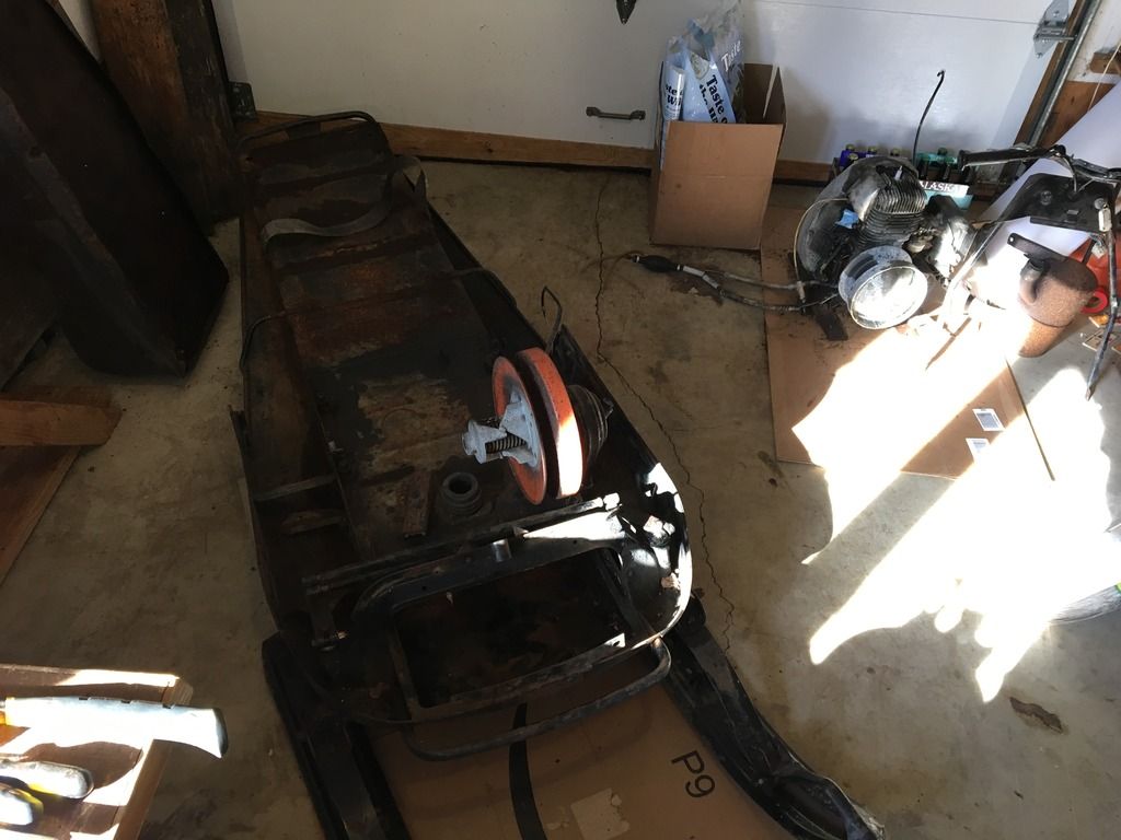

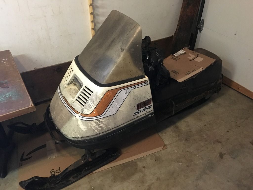

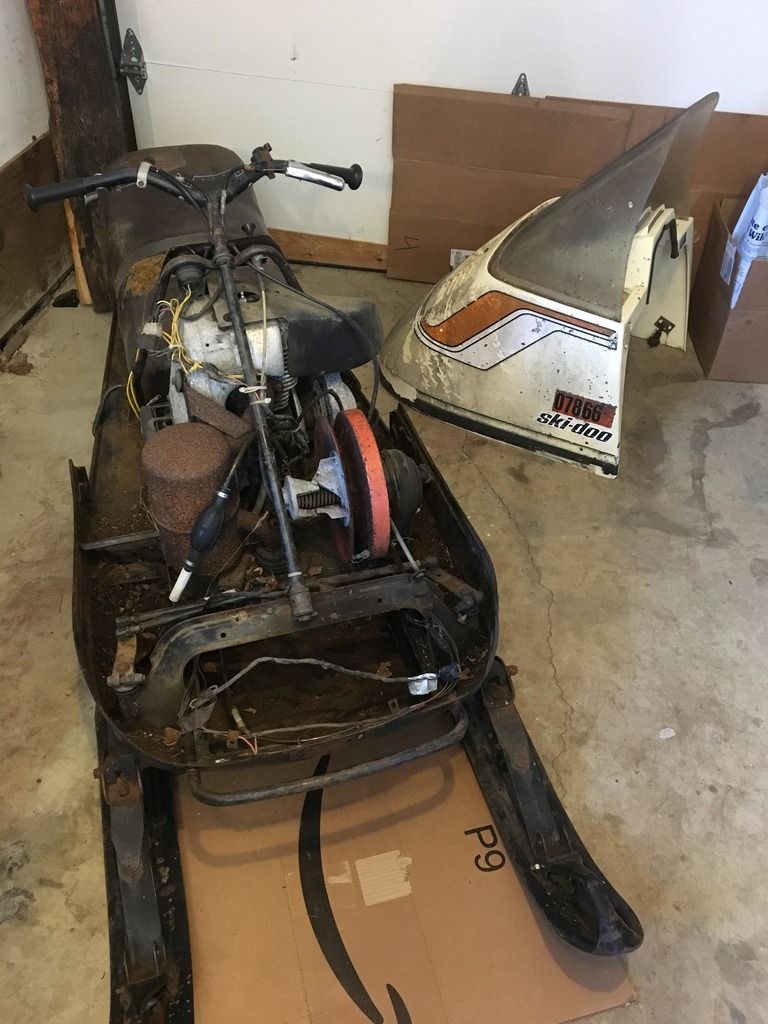

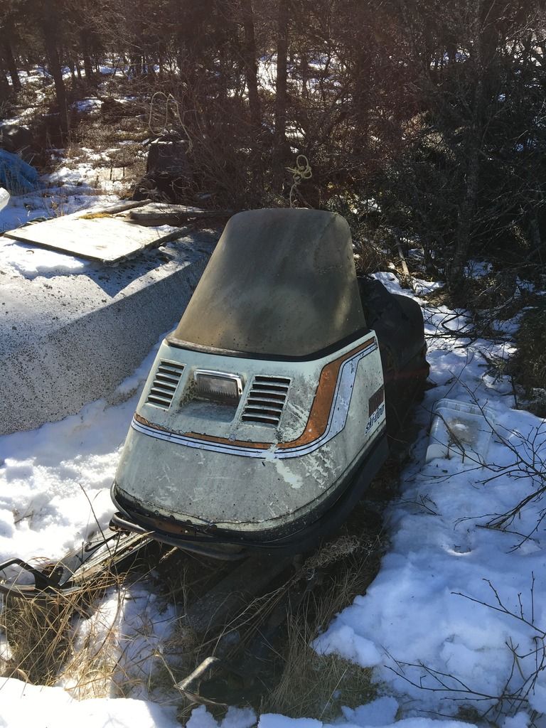

Well got the welding repairs and most of the painting done over these past couple days. I guess I'll start with a couple pictures of how I got the sled
Cowling is in good shape, just a bit dirty...a couple small cracks where it bolts to the hinge is only damage. Seat has a tear in it and was water logged. Chassis is in pretty rough shape. Bad rust under seat and a spot next to the chain case where it was completely rusted through. Engine has good compression. Track and bogey wheels are surprisingly in good shape.

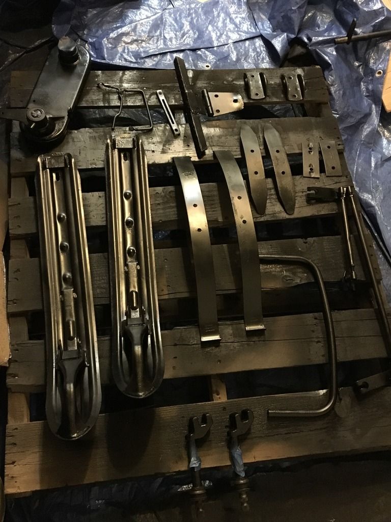

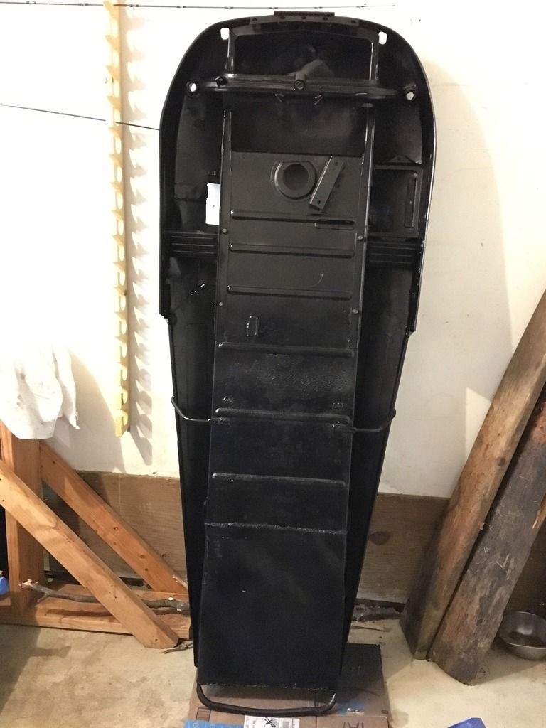

Here is the progress so far.
Some small rust holes still on the foot board area by the chain case. And some dents under the gas tank that didn't want to straighten out. But good enough for my liking. She'll definitely be a rider. Not trying to win any awards from it... Will keep you guys posted on how things go from here.

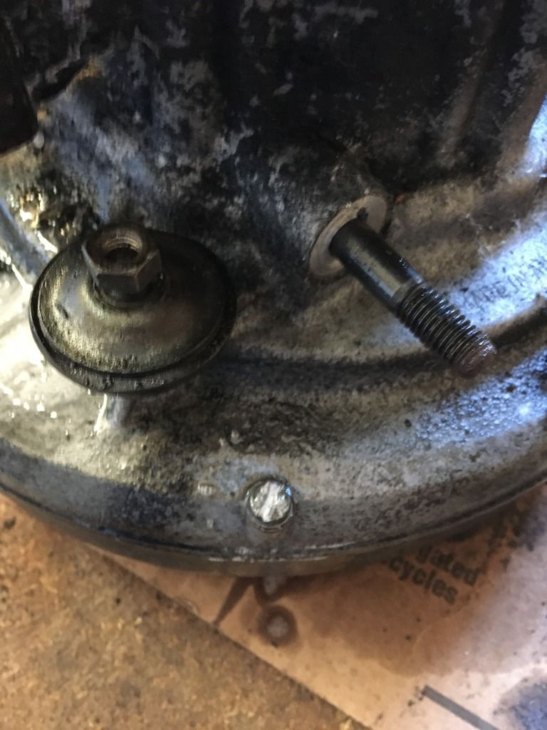

A bit of a hold up right now. Trying to disassemble the motor to rebuild with new gasket kit and can't seem to get one of the fan housing screws out. I managed to strip it pretty good in the process too. Hopefully I'll be able to get her out without having to cut it off. Any ideas on how to go about it from here? I was thinking if I grind a notch in it i may have a chance at trying to extract it without damaging the screw to much. Otherwise I could maybe weld a nut on top of the head and try getting it out with a socket. Last resort is grind the head off and loose the screw.

They can be a real pain sometimes. I take a torch with a small brazing tip and put a little heat on it and work at it they come out for the most part but they can be stubborn

I think there is enough of the head there to make this work ... deepen the slot with a narrow grinding wheel on a dremel tool ... then use an impact screwdriver tool. A couple of wacks should get it started.
