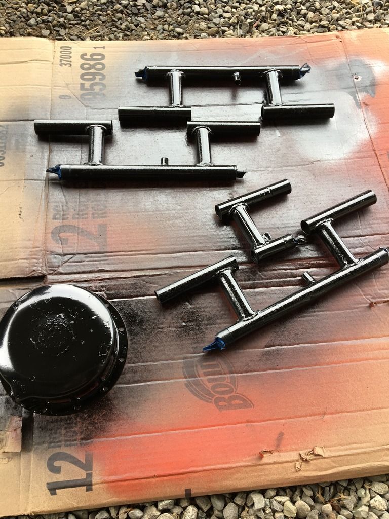

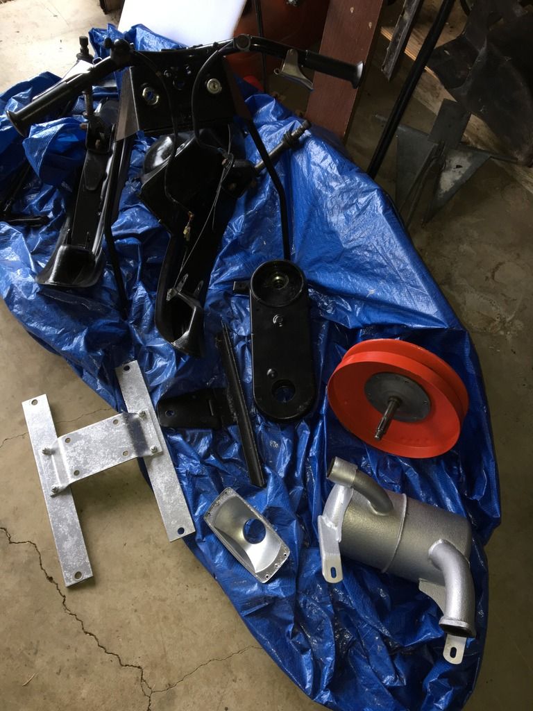

Cool. Thanks for the advice guys. Think I'll try and grind the slot a bit more and put some heat on it. I have a buddy that has an impact screwdriver set so I'll try that too. Got a couple tubes of grease in the mail, should arrive this week. When I get them I can start putting things back together. Going to clean out bogies and re grease them and cross shafts. Got everything except the cowling painted. Here she is so far...

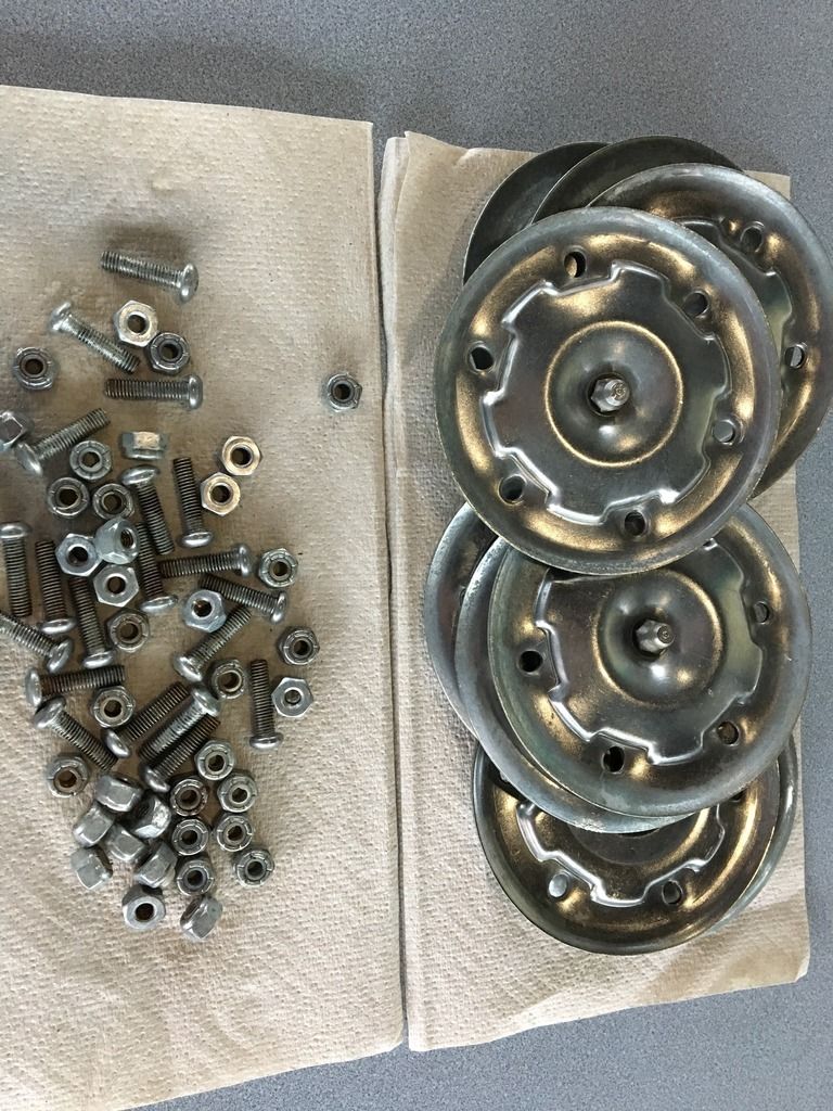

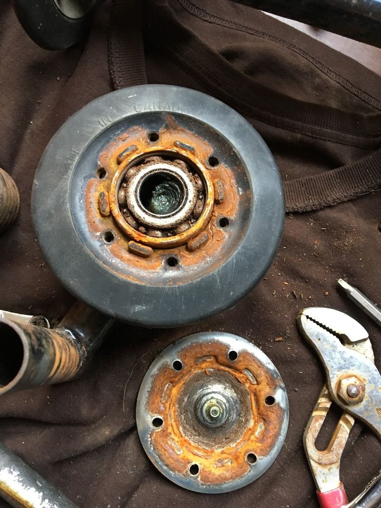

Bogie tires are all in good shape. Not worn down or dry rotted. But the bearings will all need to be replaced. They're in rough shape. Sure glad I took them apart to check haha. Going to clean up the flanges and reuse them.

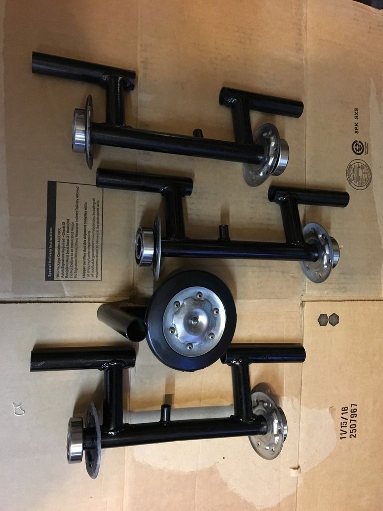

Got the flanges cleaned up to my liking. Reusing all flanges and hardware to save a little money.
Got the new bearings in and started to assemble the bogies. Nice to be putting things back together.

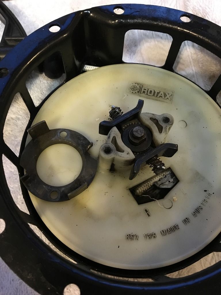

I'm having some difficulty getting my recoil pawl back together. Can't seem to get that little cover on correctly. Of course I didn't take any pictures of it before I took it apart... Anyone happen to have a picture of how it goes on or could maybe describe how it goes? Here is what I'm talking about.
1974 Elan (project sled)
2001 Tundra R
Elan Dude
Posts: 657
JUST DOO IT
Re:Starting my elan rebuild
« Reply #25 on: May 12, 2017, 04:19:25 AM »
Would this help?

Yes. Thanks.

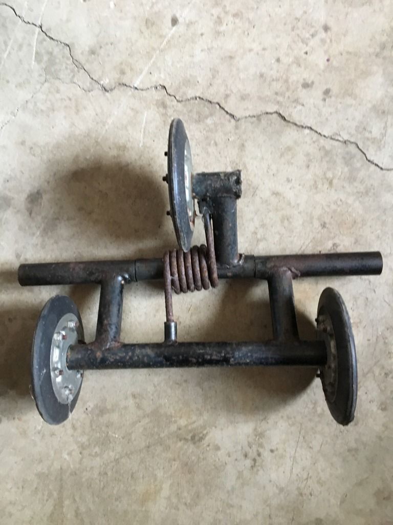

My bogie set that came on this sled are three sets of three bogies. Am I supposed to just have one set of three and the back two have four? Or will the three sets of three wheels be suffice?

My personal preference on bogies is three sets of four per truck from any old Olympic only because I'm not the smallest guy and the more support the better.  The lighter elan bogies had less springs, so it's really up to you.  Try it with what you have and see how you like it.  Bogies are easy to swap.
