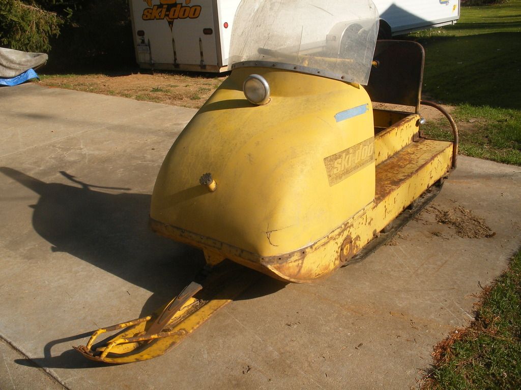

Here's my RD-8
« on: November 23, 2016, 05:58:01 PM »
oly_man
Posts: 2509
Re:Here's my RD-8
« Reply #1 on: November 23, 2016, 07:23:24 PM »
Thats a coool sled!  Aside from the tin work you have to do it looks really good.  The carb cover is still there along with all the lighting hardware!  Even has the 63 fancy exhaust.
Cool find.
