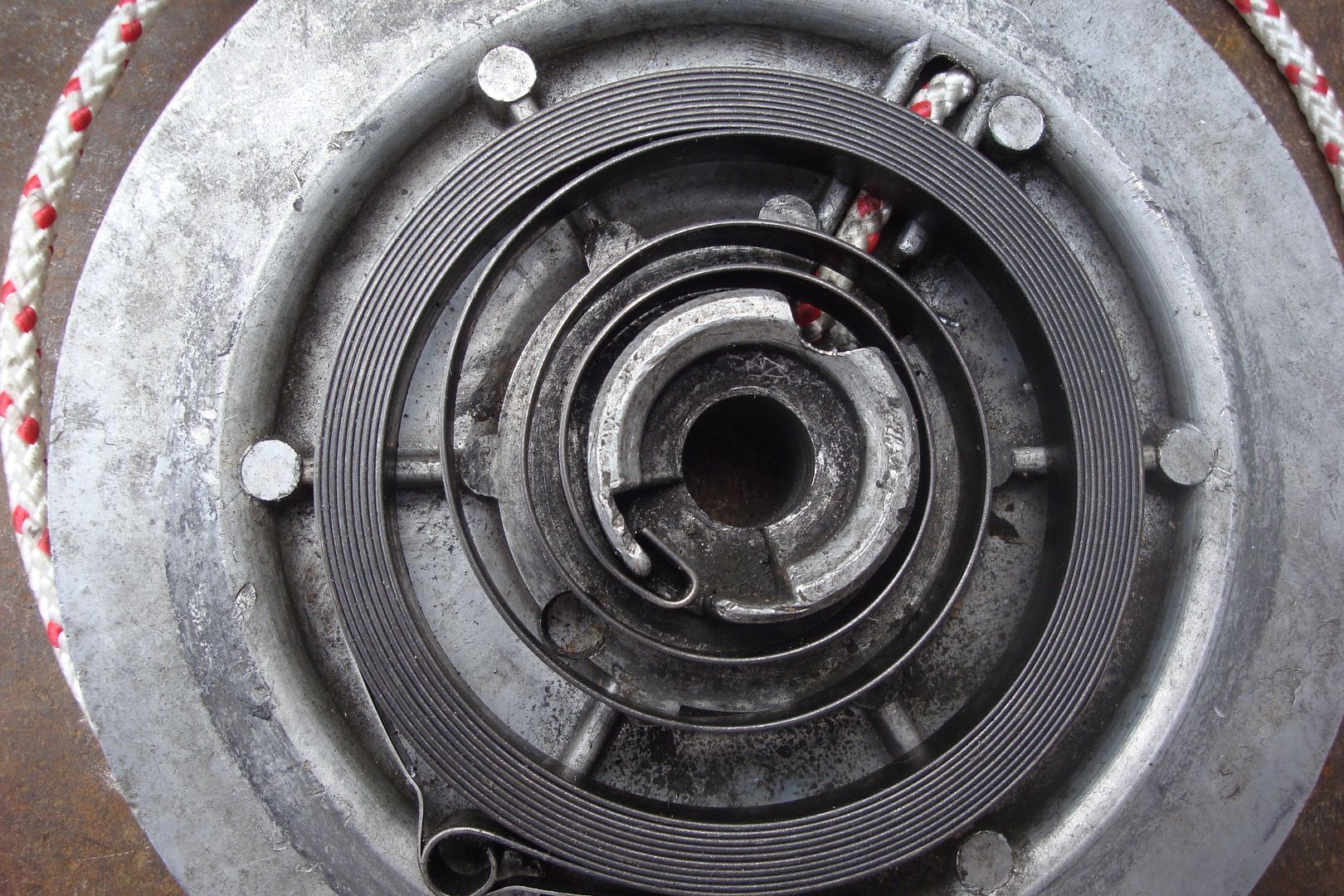

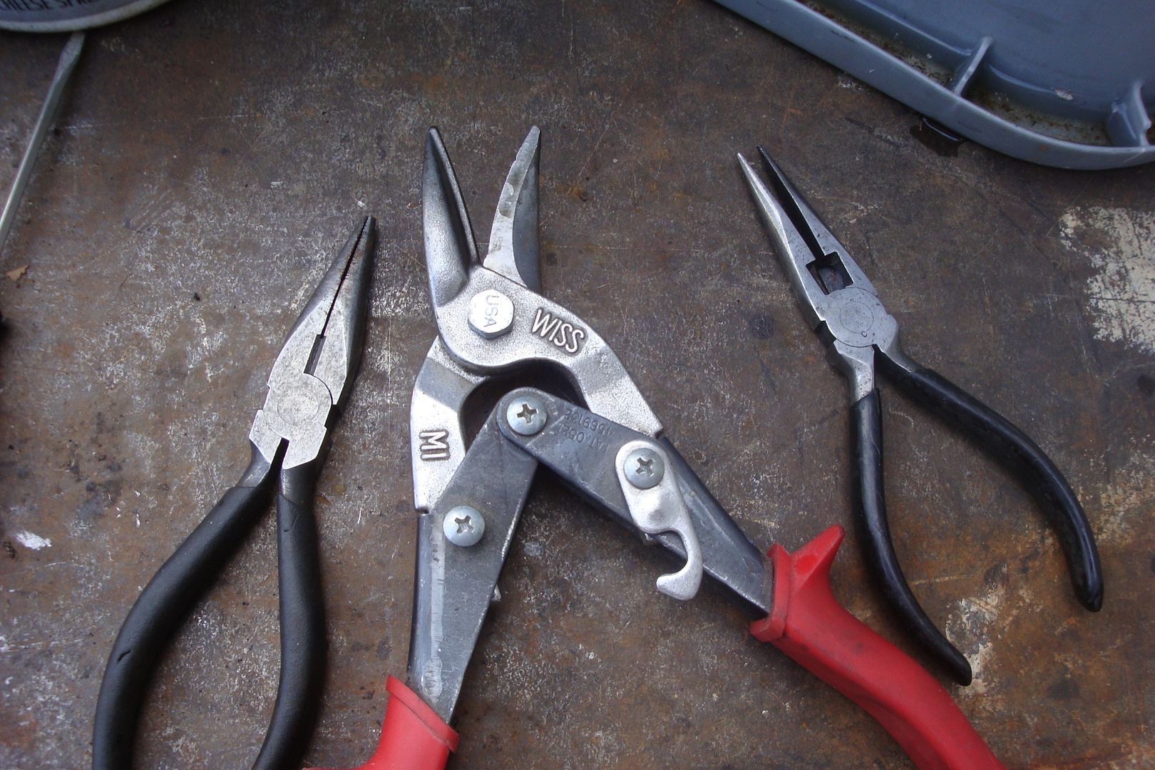

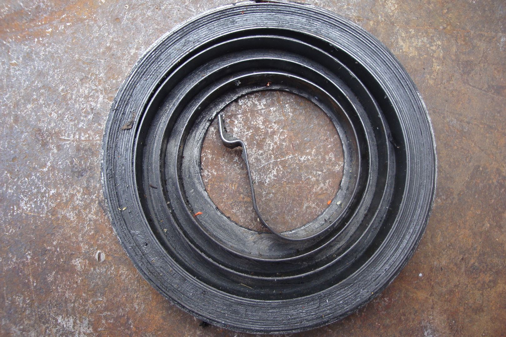

HOW TO FIX A RECOIL SPRING.THESE ARE THE TOOLS YA NEED.
BEFORE DOOING ALITTLE BENDING
WHAT A BRAND NEW ONE LOOKS LIKE
AFTER YA CUT ABOUT 3/8 OF THE OLD SPRING OFF. WHERE THE BEND IN THE SPRING WAS IN THE FIRST PLACE
SLOWLY AND DOO NOT TRY TO DOO IT ALL AT ONE TIME. IF YA NEED TO ADD ALITTLE HEAT FROM A HEAT GUN  TO HELP YA. FINAL RESULT
