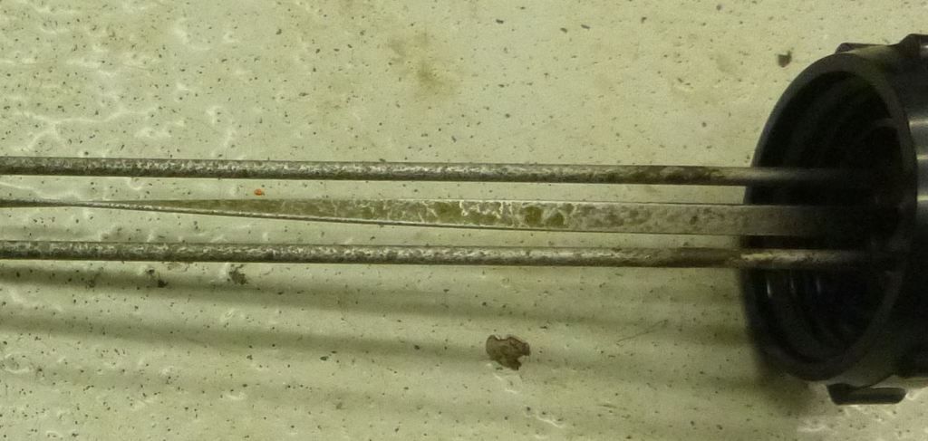

I thought I’d try it on metal that was not chromed, yet significantly rusted. The gas gauge of a 1970 Nordic was selected for the experiment.
I found a  large enough container for the gas gauge, and then allowed the part to soak for two or more days while intermittently stirring the solution. Remember to use precaution when using oxalic acid and follow directions printed on the container. It has effortlessly removed rust to a better extent at a more cost efficient price.
Cleaned up the fuel tank fitting also:
Is it a miracle?  No….but way easier on the pocket book and performance than some of the other products available.
