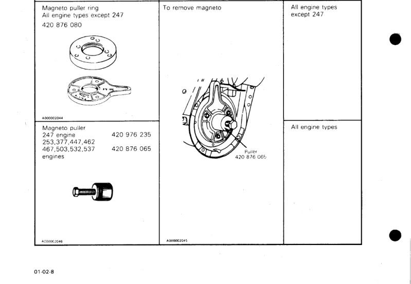

what is the part ## for a fly wheel puller for  74 400 396 F/A engine and who sells it jaw puller is too risky an  with the studs sticking out everything i have doesn't work i can build a tool out of some steel plate , i think it better to buy correct tool instead  Thanks guys
2cyclemech140
Re:fly wheel puller
« Reply #1 on: October 19, 2010, 12:23:09 PM »
the part # have been updated 420 876 065 is now 529 035547 is the puller & 420876080 is now 420876081 and it is the holder , these tools are used in water craft repair currently and can be purchased through Parker in AZ for around $80 + shipping , see what happens when you have time to goof off at work

      I cut a hole in the center of a plate of sheet steel with a hole saw cut a circle around this hole so it looks kinda like a dough nut drilled 3 holes that match lower fan belt starter pulley bolts. Bolt it on with the 3 nuts and use a 3 jawed puller works very well took about an hour to make.
Kash
69nordic
Posts: 239
Re:fly wheel puller
« Reply #4 on: December 20, 2010, 08:10:20 PM »
After reading my post even I was confused. The piece I made looks like a thick giant washer it fits on the flywheel the crank shaft stlcks out the center  the plate bolts to the three fly wheel studs. the nuts only thread on three quarters because you have to leave a gap to slip the jaws of the puller under.you need a good quality puller as the jaws are very thick on the cheap ones I hope this is clear.I bought two rotax pullers years ago I never could figure out how to use the twin cylinder one until I found out it needs the bolt on plate which I don't have and on a hazy day after to many wobbly pops I put the single cylinder puller away some where safe as I said I bought two of the same pullers and I only need one still can"t find It

nope that is the puller for the twin, the single puller has the threads on the inside
moxy
hermit
Posts: 3605
Re:fly wheel puller
« Reply #9 on: January 15, 2011, 07:42:17 AM »
the single cyl tool is ski-doo/sea-doo part number 420976235. Motion Pro makes one like it for less but don't know the number price quality etc. I have the one listed above works really great. A breeze to pop any single and Opposed Twin flywheel for ski-doo, maybe Sachs and Jlo.

That is correct, however you also need the porkchop to go along with it.

OK!  I was wondering how, w/o any male or female threads on the flywheel of a 399,640 how the puller would work...You bolt that pork chop frying pan around the 3 bolts that hold the starter cup-then screw in the puller to that pulling out the flywheel...
Is the pork chop avail with the puller?
seems Ski doo went to great lengths to make this one difficult to pull ie-with a combo of parts to make it work..vs the 340--just screw it on and pull it..

When i bought my puller and frypan it was around 100$ from the brp dealer...
