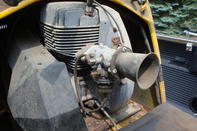

Here's what I started with, $150 about 40 miles from home, didn't even bother to try and start it
came with a "newer" 299 which is being replaced with a '67 299 14.5hp. It's on the bench and nearly done, photos to come.
pretty typical topside, no rot
It took some hard hits. Tank was cut open by a previous owner, clean welds, was holding fuel when I bought it
