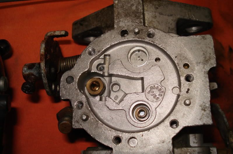

Yes, that's the hole. My real question is the non-threaded check valve.
My search turns up # 016624 which crosses over to Bombardier 404 0363. Is that a correct number? See link to photo. Who might have those?
[/url]
DSC00039 by Mr Wrenchy, on Flickr[/img]

I'd like to see the nozzle from another view. Appears much like an HD, not that would be any more plentiful. Never saw one of these I recall.

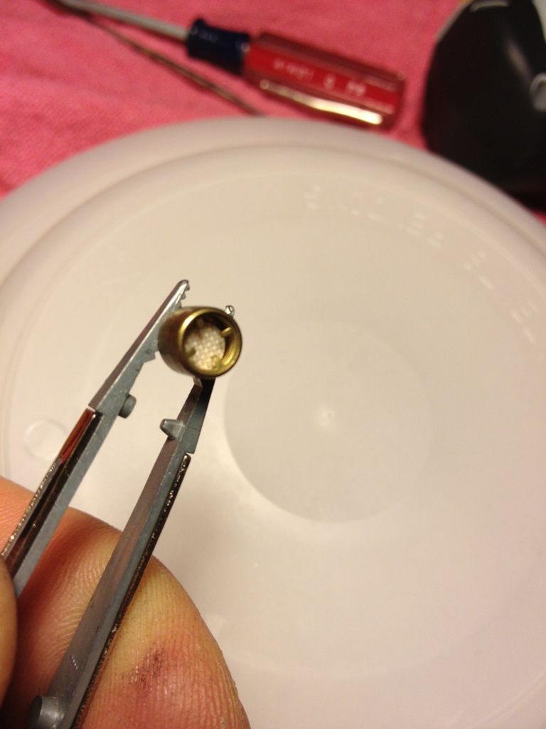

« Reply #12 on: February 3, 2012, 06:52:23 AM »
what it looks like from under the welsh plug,
moxy

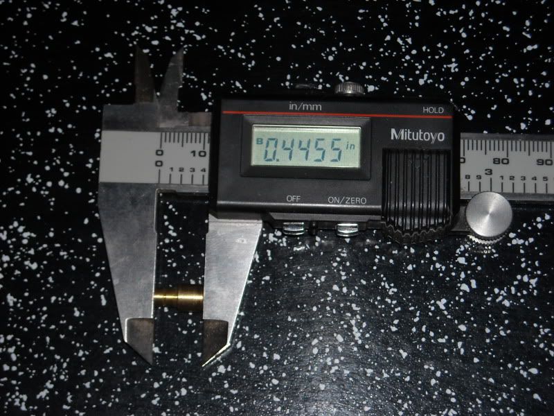

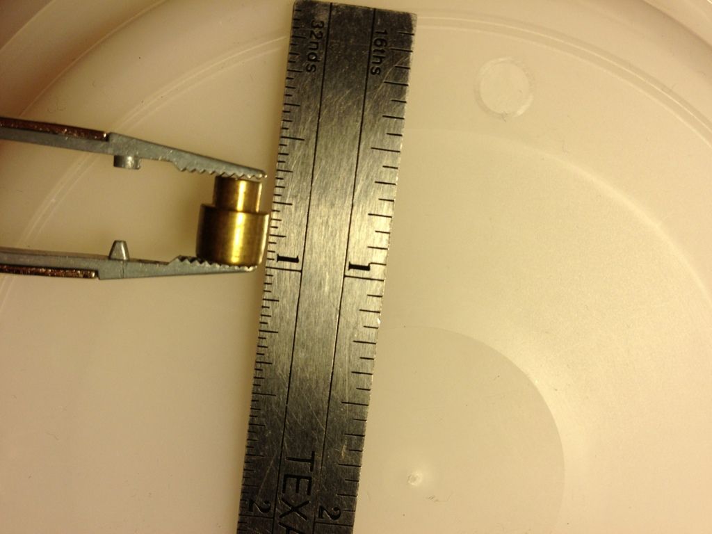

HI  just received in the mail 2.. 4040363  nozzle check valve for HR137a      does have a ball check valve with a flap over it with 4 brass fingers to hold everything in place.As for the length it is .308 in length compared to hd valve at .445 long
Flap valve looks to be made of a woven fiberglass material.
If you need more info I will not be installing them for a couple days
thanks  Gaston
ph 705 272 6677
gave 3 pics to  Moxy to post for me

« Reply #19 on: March 14, 2012, 05:24:07 PM »
Gaston said that the HD check valve when shaken the ball feels like it has more travel than the HR.  He was unable to see the ball in the HR.  But believes there is more to it than the fiberglass screen
moxy
Gastons Pics
HR is the short one
HD with check ball, the mark on the shaft might be where to cut to fit HR/HL
HD on the left, HR on the right
