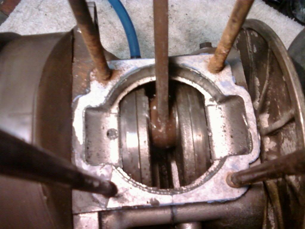

Top of `71/72 crank case, note the transfer area more toward the exhaust side. ( note did not take pic of `70 case ). The `70 case has the transfers about centered from intake to exhaust.

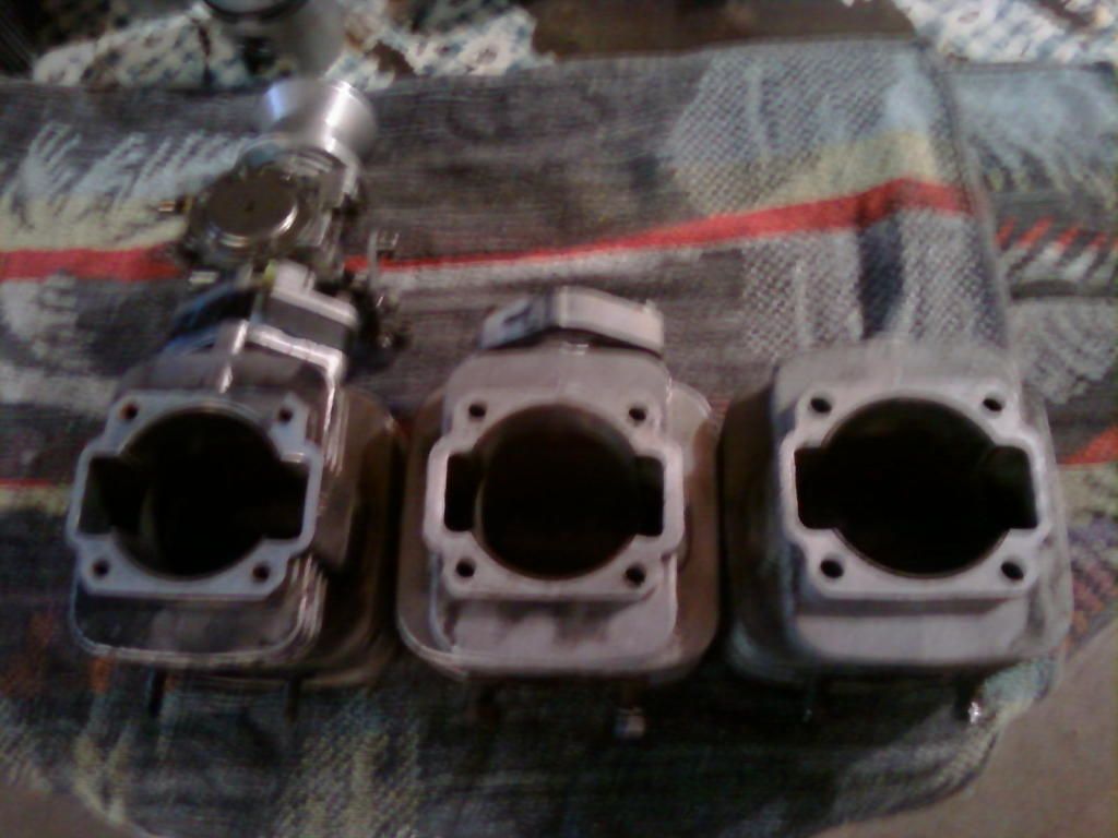

3 different cylinders. On left is `72, middle is `71, right is `70. Note on left one the transfer area is more toward the exhaust ( kinda` matches the 72 case ).
Middle one is interesting, the transfer area is more positioned like a `70 jug but the material around the transfer is very thick, thus this jug base will fit and seal on any of the `70 to `72 crank cases.

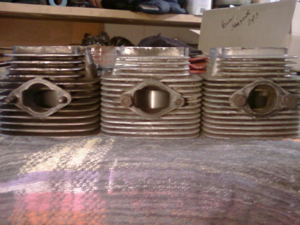

Pics of exhaust port, again left `72, mid `71, right 70
72 & 71 same, 70 diff.

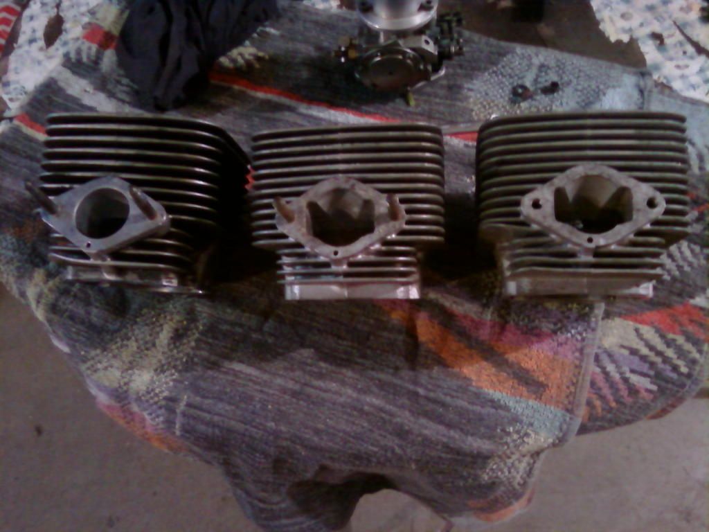

Intake ports, `72 on left, 71 - mid, `70 right.
`70 & 71 are same, `72 is diff.

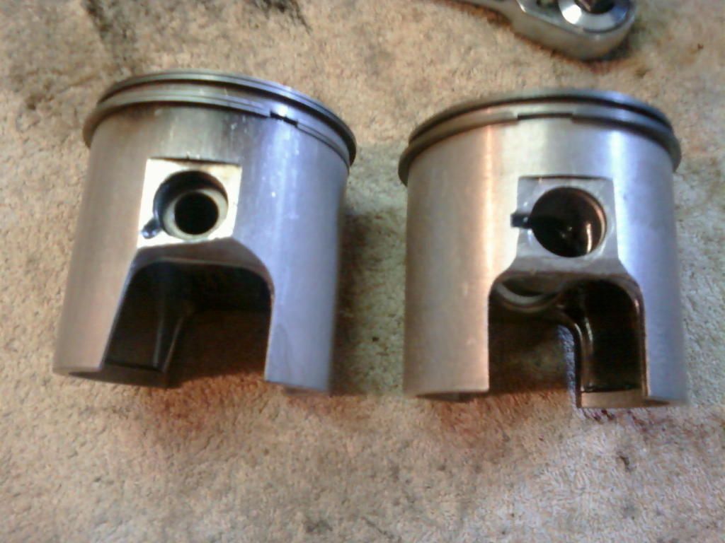

`71/72 piston on left, `70 piston on right

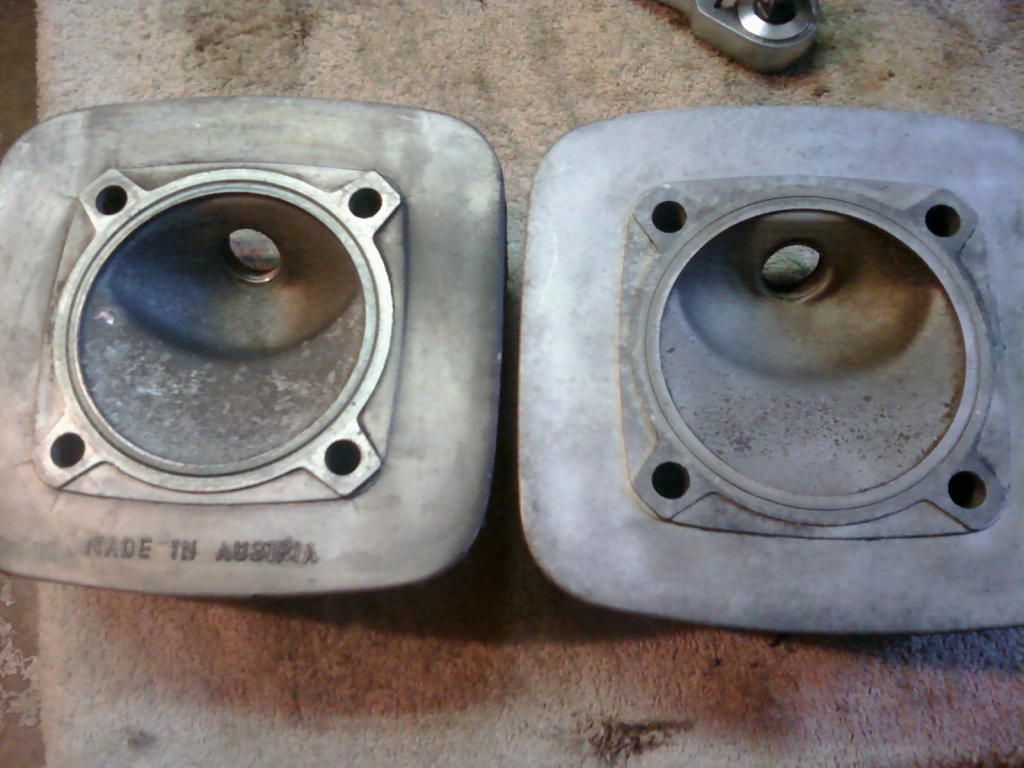

`71/72 head on left, `70 head on right.
The `70 head has a smaller volume, it is visable that the built up part travels more toward the plug hole side on the `70 but it is also thicker ( closer to piston ).

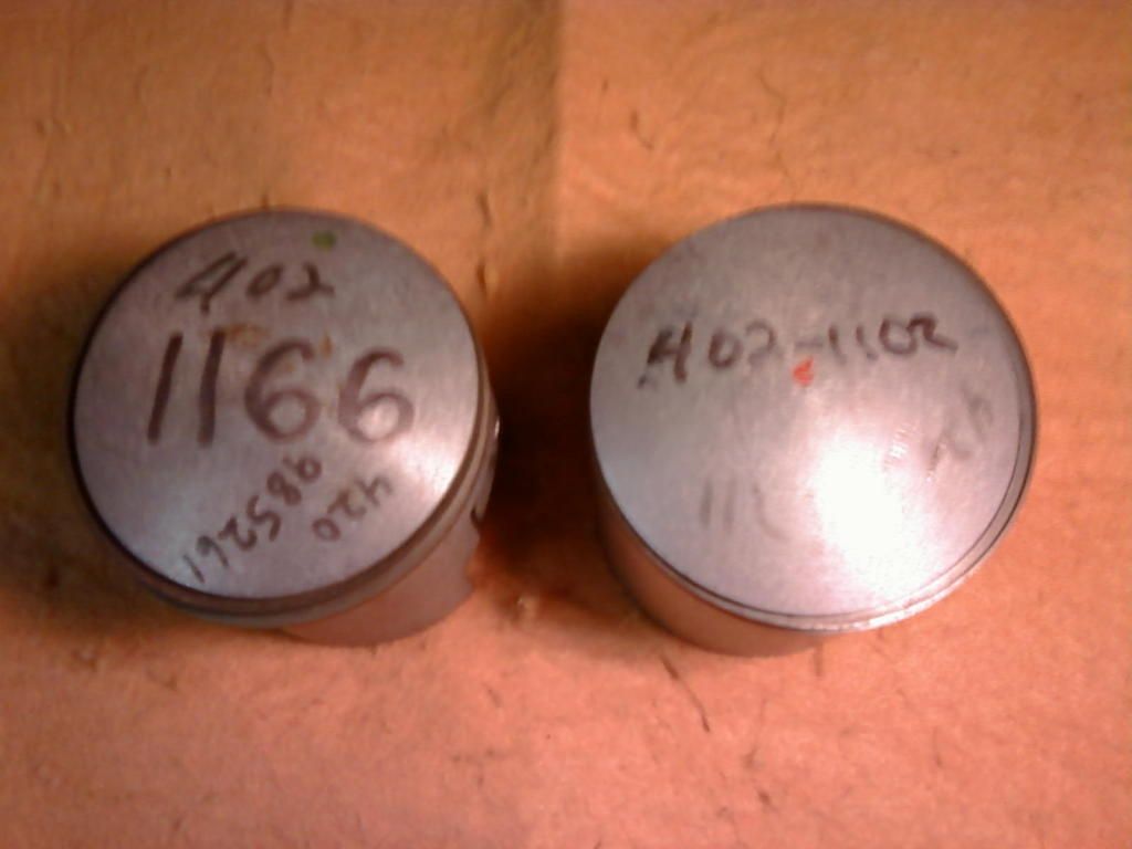

A few more pics that can be use full for 292s.

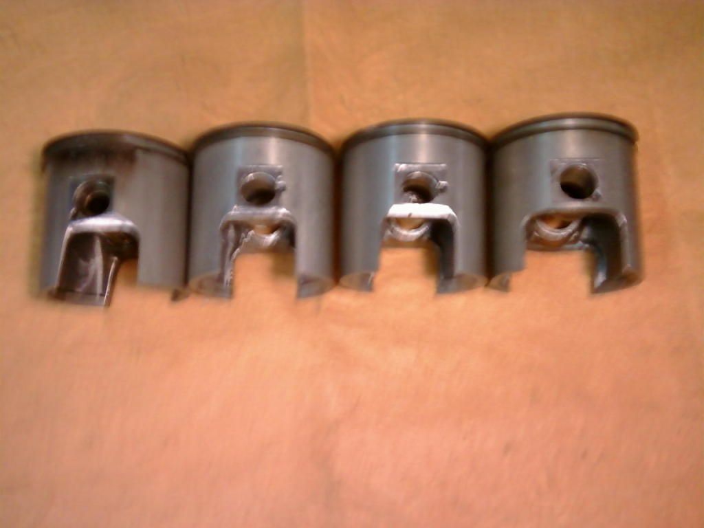

On left 71/72 - 292 piston, mid / left 69/70 - 292 piston, mid right 300 sport kit piston, right 70 - 640 Blizzard piston. Pic quality not too good, phone pics.
On left 69/70 - 292 piston, on right 300 sport kit piston.

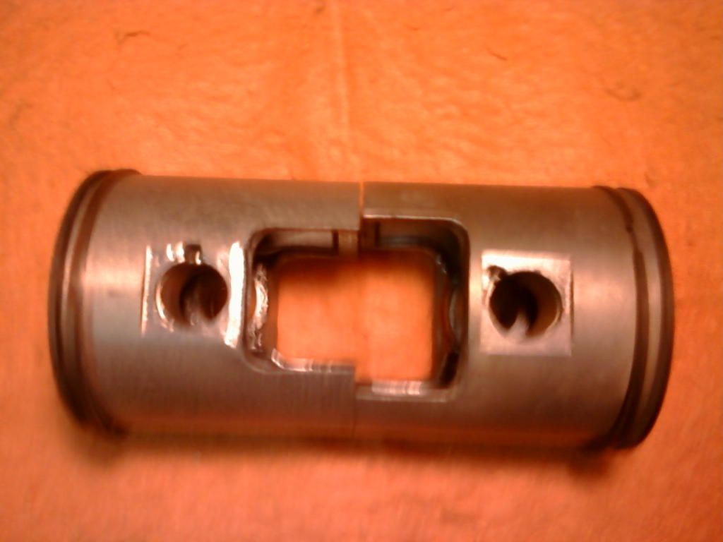

On left 69/70 - 292, on righ 300 sport kit

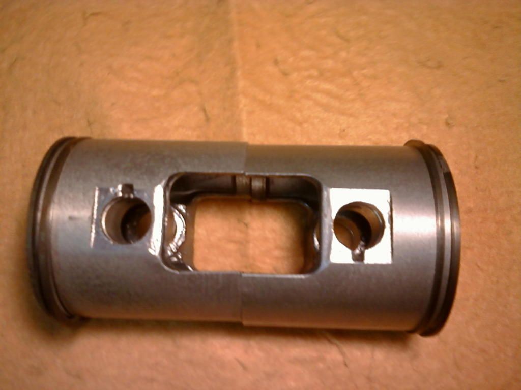

On left 69/70 -292, on right 640 Blizzard.

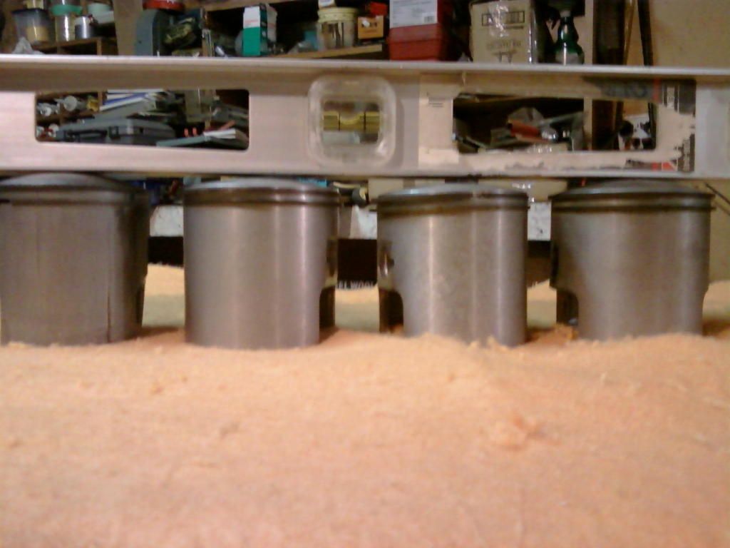

On left 71/72 - 292 piston, in mid 69/70 - 292 & 300 sport, ( they are really both same heigth pic is decieving, on right 640 blizz piston
