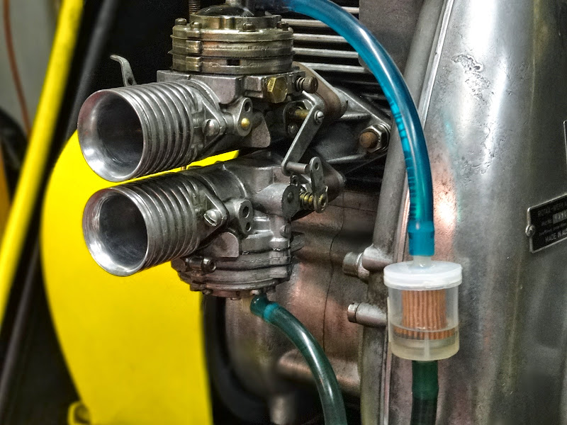

Olympic S with the correct pair of carbs in photo.
Definitely hard to find and they can be expensive.
14HP seems correct.
Top carb is LO speed with a LO speed adjustable jet, HI speed is fixed, has a ball check valve and a choke.
Bottom carb is HI speed, only has a high speed jet, no low speed, no ball check, no choke.
I think the difficulty in keeping them running is getting the pulse from the crankcase to the carbs. Many places to leak between flanges. The HR+ end of the Y adaptor has a 360 degree pulse groove vs a pulse hole, definitely difficult to seal. Once they are sealed they will run.
Cannot find any gaskets for the HR+ that do not encroach in to the pulse groove, need to hand make and then spray with copper gasket seal.
The plastic carb isolation spacer that is on your cylinder is period correct. Hang on to that one.
When riding the sled most of the time it's only on the top LO speed carb, gets excellent gas milage.
One thing I've noticed is the primary clutch requires quite a few shims to get it into alignment with the driven secondary pulley. This was an issue in 1966 and on the recent 2 sleds we are running with the same motor. Not sure why.
Nice find.
A good in-line filter and the finer stainless steel screen in the carb will keep it starting and running well.
The photo below has the carb with a triple stack of plates, a double is correct. I tried the triple just to see if it made any difference, it doesn't. Just haven't gotten around to swapping it back.
The linkage between the carbs has the top carbs lever contacting the bottom lever when the throttle is squeezed about half way. Because the lever on the top is 2x longer than the bottom, the bottom opens fully with the remaining 1/2 squeeze of the throttle.
The larger muffler is specific to the "S" and is painted silver vs black. This one is from Spaulding.
